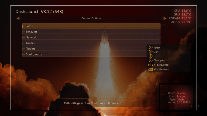

I’ve downloaded everything that’s needed and all set to go. But since it’s my first time doing so, I need afew basic info… I haven’t modded the console myself so I’ve no idea whether it’s Jtagged or RGH. Can you tell me a way to figure it out, since writing the dump file is different in both.
Open Dashlaunch and it will tell you in the bottom right what you have.
Example

I’ve got DashLaunch it contains several files, should I just open the default.xex through XexMenu just like flash360?
Got it… It’s Glitch2, Which means its RGH… So, for RGH Xell is used to write the nand file, right?
