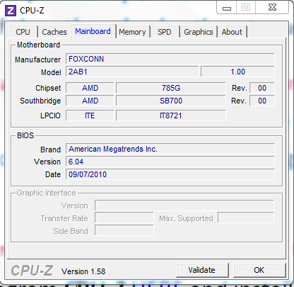

You mentioned it would detect your PC DVD drive, so unplug your PCs DVD drive and plug your liteon in that port(worked for me when I flashed mine).
Otherwise, you might need to try DOS flash.
Yep I had a bit of trouble with it but this is what i did I plugged it in the back port when i switch the pc on you no if it gonna work theres a green light.Then open jungleflasher and then plugged it in the front hope this helps there’s alot more help on xbox360iso.com
You have drivers installed for your card, do this buy going into your device manager.
Start –> Computer –> Mange –> Device Manager
Uninstall the drivers by right-clicking the device and looking for the option.
If you’re on Windows 7 make sure you’re in Test Mode or have disabled driver signature enforcment. Remeber, Jungle Flasher uses its own driver, the Port I/O one. You can boot into test mode by hitting F8 on Startup and looking at the start up options.
Try using a SATA port on the inside of your computer.
A lot more practical.
