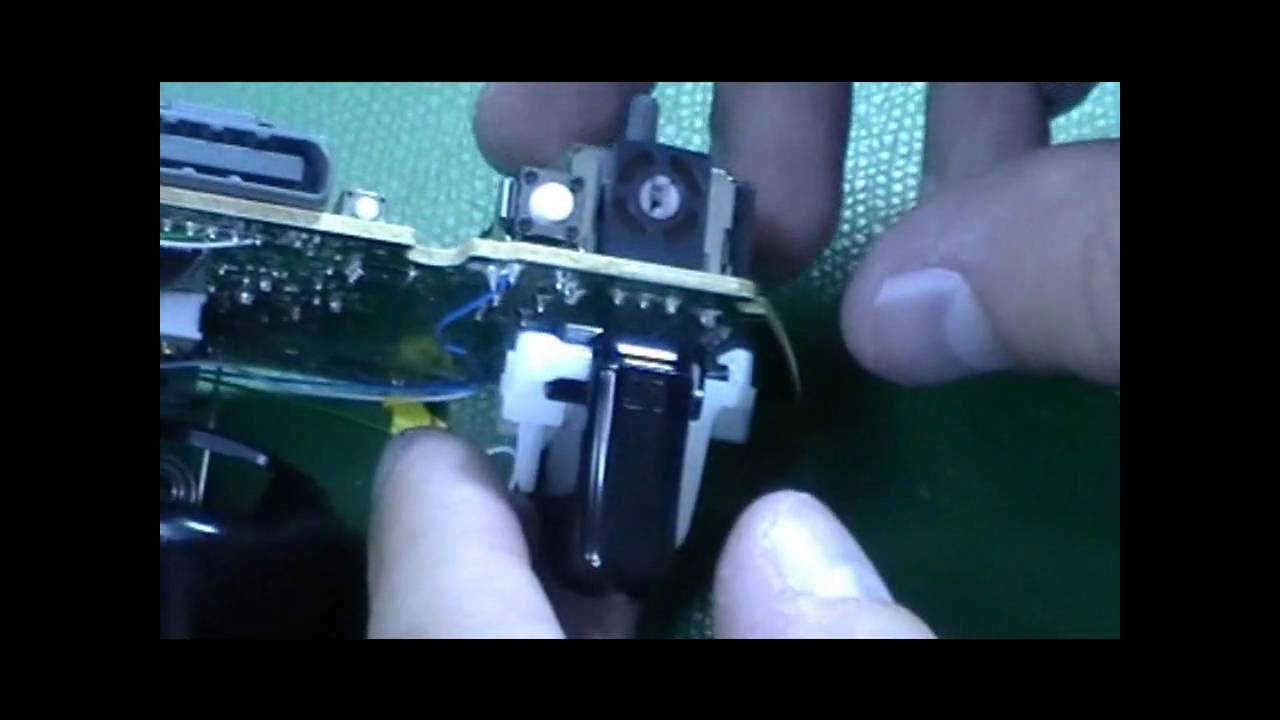

Next your triggers. Triggers starting to make a annoying squeaking sound or getting harder to push or are your triggers out of place? Here are some ways to fix it.
- clean triggers/springs
- clean the trigger holders
- clean the inside of triggers
- push your trigger holder back into place
5.(Do not do this step if you cant solder!) If it is still messed up your going to replace the trigger holder by de soldering the 3 little pins on the front side of your controller(here is video link to do it
YouTube - Replace your XBOX 360 controller thumbstick or trigger mechanism
