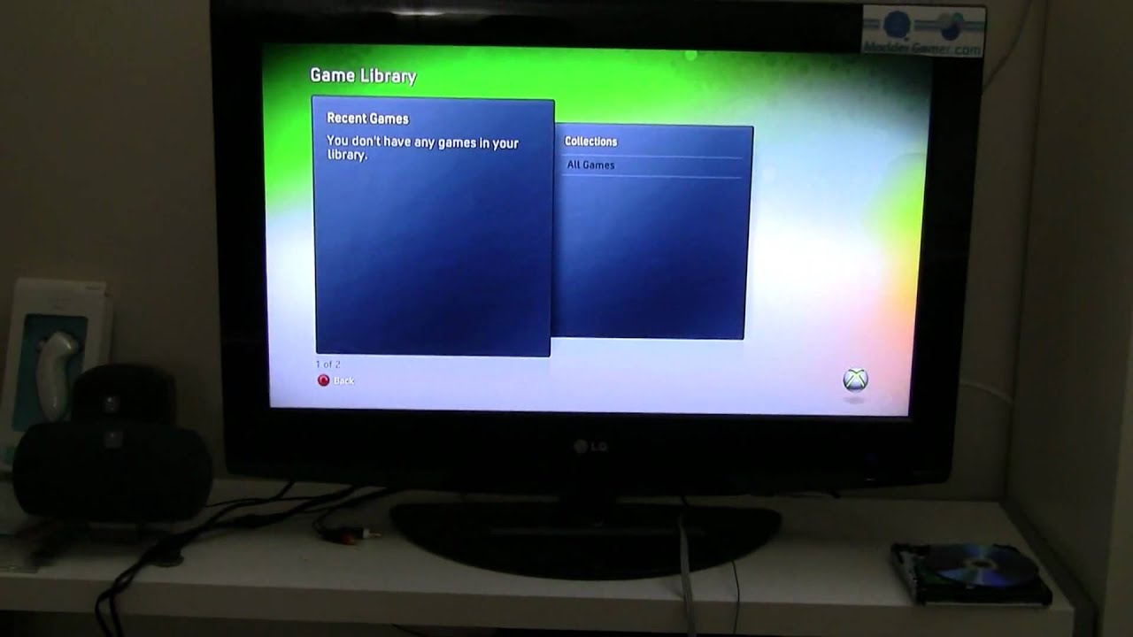

Step11:go onto your jtag and play xex menu (found in game library)
Step12: hit right bumper and go down to your games folder hit mw2 iso look for default xex and play it
step13: go into split screen and enjoy hope this helps

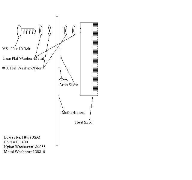

Step Four
The necessary parts for this mod are very inexpensive. You will need the following parts:
8 M5-.80 x 10 Machine Screws
16 #10 Flat Washers – Nylon
16 5mm Flat Washers – Metal
Artic Silver thermal compound
I know that some people have used Fibre washers instead of Nylon. It probably doesn’t’t matter. If you can find Fibre, I would suggest that instead. I could only find Nylon, so there you go.
Step Five
Ok, now we have clean chips & all necessary equipment for the fix. Here is an illustration with the hardware replacing of the “X” clamps.
Note that the Nylon washers are up against the motherboard on both sides – not metal. With two washers (1- nylon, 1- metal) on each side of the board, this matches the original spacing provided by the “X” clamp.
Step Six
Here is probably the most important portion of this tutorial. PLEASE PAY CLOSE ATTENTION! Once you have replaced the heat sinks like the illustration above (don’t tighten the bolts down – just snug for now), set the motherboard back into the bottom case. Don’t screw it down yet. Replace the Power button board with the lights, so we can see when the 360 overheats. I plugged in the DVD & set it aside on the edge of the case (not sure if this is necessary). Leave the fans off for this part. The video plug must be inserted or the 360 will auto-shut off, and the power brick must be plugged in. Turn on the Xbox & most likely you will see the 3RLOD – Red Lights Of Death. Without the fans, it’s a matter of time until the box overheats. When this happens, it will change to only 2 lights (both left side lights). I waited 2 minutes exactly, then shut it off. This allows the solder problems to fix themselves by getting hot enough to re-solder themselves in place. As this is cooling off, take the board out to where you can tighten the M5 bolts down snug. Don’t over-tighten them, but in my case – I got them very snug.
Step Seven
Let it cool down completely, then put everything back together. Any cooling mods that you could add to this fix will only help the situation. There are several out there: 12V mod to the existing fans, aftermarket fans, or even the cut-out of the case itself. All will help the temperature overall.
GOOD LUCK…you’ll need it :wink:

~God file emulators (Which go within the stock hdd only and show up in the game library in the NXE Dashboard).
~.xex file emulators (Which will not show up in the NXE Dashbourd but can be put in either the stock or external hdd.)
