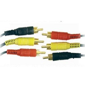

Other things you might need:-
RCA to RCA composite cable
Male to Female RCA splitters

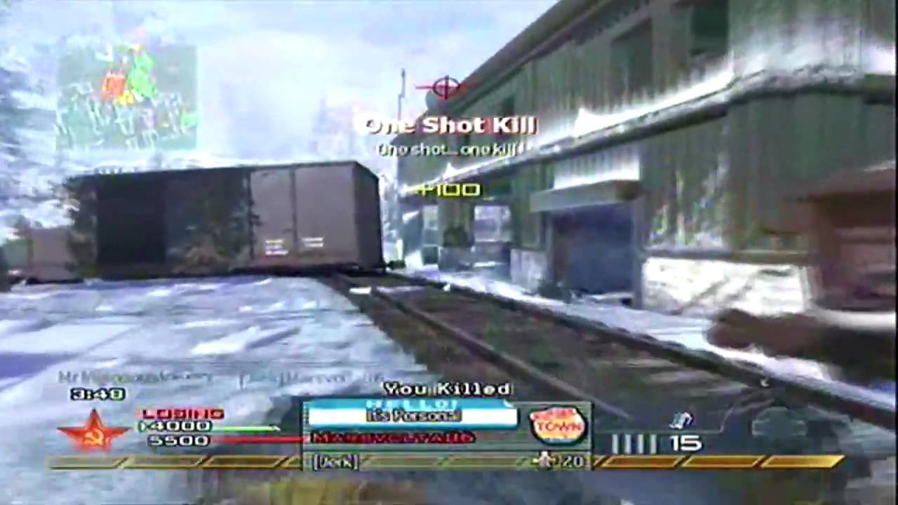

Quality
This is the type of quality you can expect from the easycap, obviously this can be improved by using different render settings.

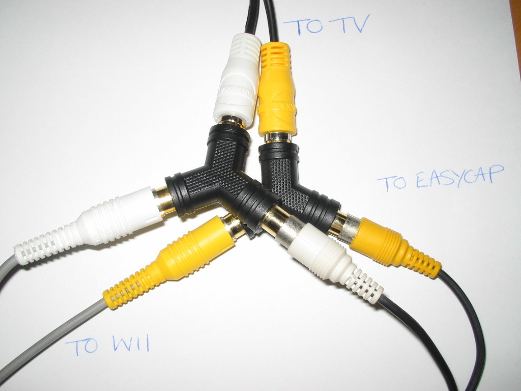

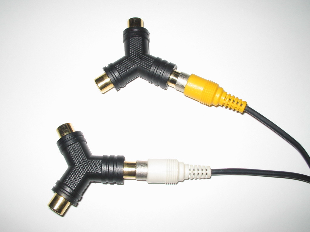

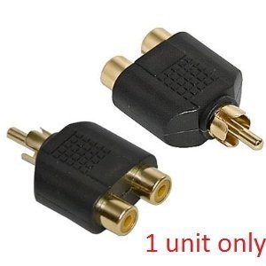

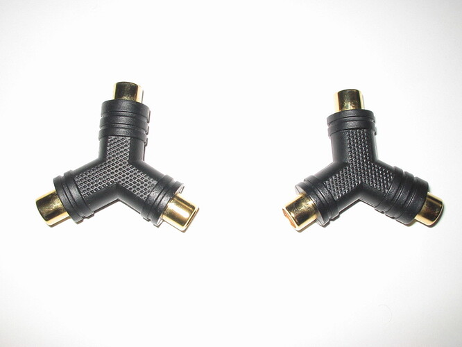

for this tutorial i will use just 2 splitters.
This will enable you to play the console on your TV whilst recording the game on your laptop or PC
phono splitters -
2 sets of phono extension cables
Now from the Easycap connect 1 set of the phono extension leads to the correct colours yellow on yellow for Video the other end connects to 1of the phono splitters
Repeat with the white cable and the other cable splitter, itshould now look like below
take the second set of phono extension cables and connect yellow(video) to the splitter, the white cable (audio) connects to the other splitter with the white cable
The other end of the extension cables goes to your TV, select the correct channel for the AV leads. Now you will need to connect the Wii AV cables to the splitter, following the same trend as before yellow (video) to the splitter with the other video cables, and white (audio)cables to the splitter with the white cables connected. You should now have this setup below

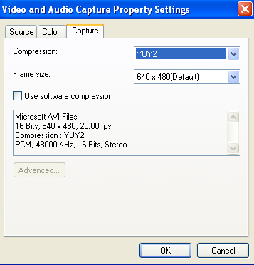

Launch the Ulead software and follow the following steps
click capture video
click options, select video and audio capture settings
For PAL systems make sure you have these settings
Check the the capture tab has the same settings

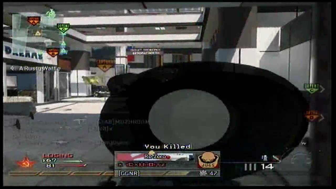

Quality
Here is the typical quality you should get with the dazzle
The quality can be improved by changing the rendering settings

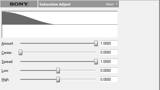

- Go back to Video FX and choose saturation adjust.
Drag to the video track and make it to these settings

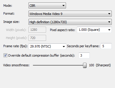

Once you have finished editing you’re clips and doing what you are doing follow these next steps.

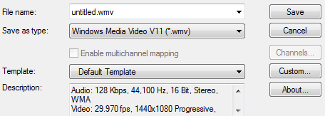

Go to File > Render as.
Change save as type to .wmv and choose default template as the template
- On the right there will be a button ‘CUSTOM…’ click it.

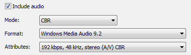

Click the audio tab
Change the mode to CBR
Format to Windows media audio 9.2
Click the video tab
Mode: CBR
Format: Windows media video 9
Image size: High definition (1280x720)
Pixel aspect ratio: 1.000 (square)
Frame Rate (FPS): 29.970 (NTSC)
Seconds per key frame: 5
Tick overide default compression buffer (seconds): 3
Video smoothness: 100 (sharpest)
Click project
Change Default template to YouTube.
Press the save button ![]()
Press ok down the bottom.

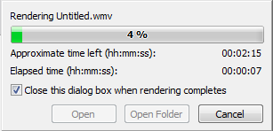

Now press save and it will start rendering.

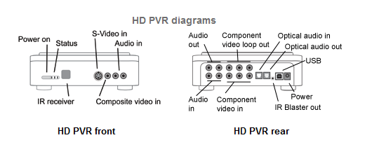

High Definition Capture cards
Hauppauge HD PVR
Open Me
The hauppauge in my opinion is one of the best capture cards money can buy. The quality is great, the design of the device is nice and the software that comes with it is brilliant and easy to use. It’s simple to set up and doesn’t require you to buy anything. The only draw back is the price which may be to much for some people.
Specs
Open Me
Specifications
Hardware encoder:
H.264 AVCHD video encoder.
Recording datarate: from 1 to 13.5 Mbits/sec (user selectable).
Recording format: up to 1080i from component video (YCrCb)
Note: the video input format determines the recorded format. For example, 1080i input records at 1080i, 720P records at 720P, etc… Any other format conversions needs to be done with the MediaConvert program (supplied).

Input and outputs
Component video input and loop through output.
Optical audio Input and loop through output.
Left/ Right RCA audio input and loop through output.
Composite video and S-Video inputs (on front panel).
Left/right audio input (on front panel).
IR Blaster output.
USB2.0 High speed Device.

Quality
Here is one of my videos to show you the quality - watch it in 720 p for HD quality.
http://www.youtube.com/watch?v=nMie2_XBIfM
Render settings can improve the quality but not as drastically as with the SD capture cards.
Good render settings -
http://www.youtube.com/watch?v=CNIqgiBuzqw
